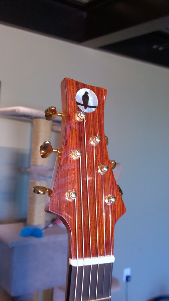

 Post subject: Re: An inlay question ?
PostPosted: Sun Mar 22, 2015 10:43 am
Posts: 1715
Last Name: Parchem
City: Seattle
State: Wa
Zip/Postal Code: 98177
My logo is shell and wood. I never gave mixing them a second thought. It is simple a simple inlay; I started making them with black MOB for the hawk, but I switched to ebony. In my case the difference in vibrancy matches a moon vs a shadowed hawk.

John ,nice logo. Ebony is one of the woods in question .
